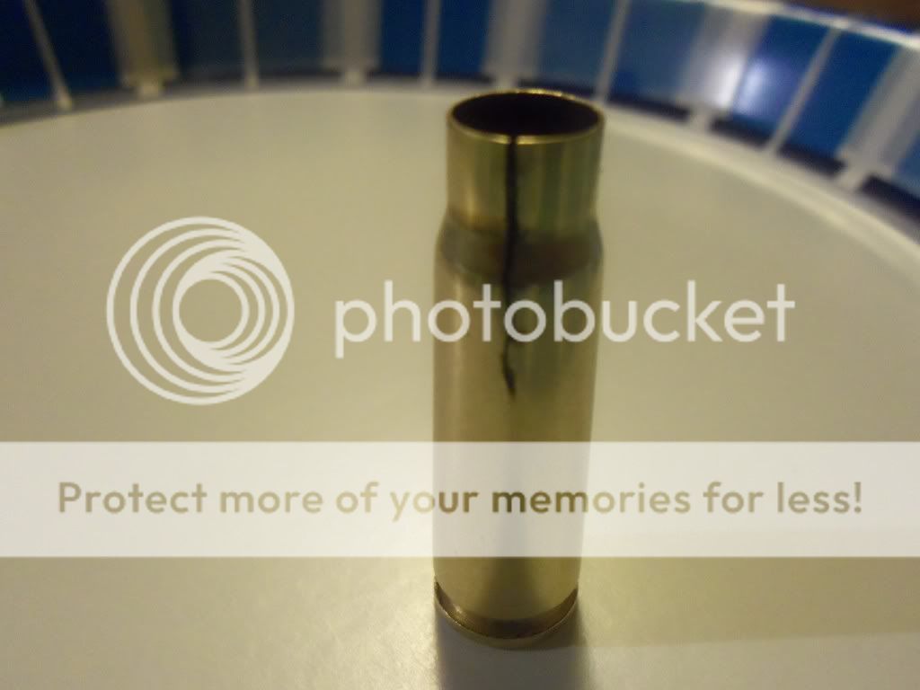

Buddy bought a New Saiga today and we had about 12 mins to try it out so we went and fired 10 rounds I collected the brass and when we got home I noticed that one of the cases had split from the top about half an inch down. We were shooting 125gr soft point Golden bear ammo, after we noticed the case we inspected the rifle and noticed nothing damaged or out of the ordinary. We did a quick cleaning of the rifle before we went out . While firing the rifle we didn't notice anything and all the casings fell withing a foot of one another. My question is how concerned with this should we be?

have seen similar case cracking on sks with lower power rounds, i figure it had something to do with either the cheap wolf i was using or the fact that the bolt smacked em just right due to lower power and not a full bolt motion.
11,238 Posts
no worries.
I am sure this is a bad case/ load. Over the years I have measured the consistency of several russian brands steel and brass and the spreads are all over the place. No much attention is put to QA. The powders are horrible too. The military yugo and some russian are better.
But hey, once in a while it happens to the best too, even Lake city, hornady or remington. I can show you some crazy case failures.

It is your brass. Try some new factory brass from U.S. and I think your problem will be gone. I was given some 30 carbine ammo from WW2 and every single one split from mouth to base so I had to junk them.
2,534 Posts
Like all have said before: brass, not gun
Improperly annealed brass specifically.
