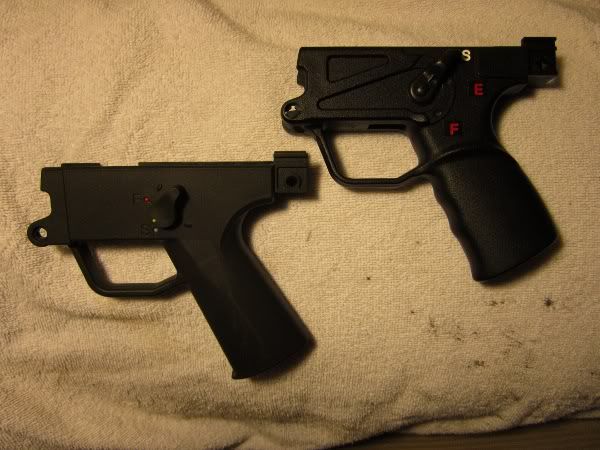

Started first by picking up a navy SEF MP5 lower and safety assembly. The lower is a direct fit to the GSG frame and has an even tighter tolerance fit to the main housings. More ergonomic grip, little nicer texture, and stiffer overall. The GSG fire control group will fit this lower, you simply need to carefully notch the side of the housing to fit the serial plate. The MP5 safety takes quite a bit more work to get to properly function in the FCG.
Stock GSG vs SEF lowers and safety:

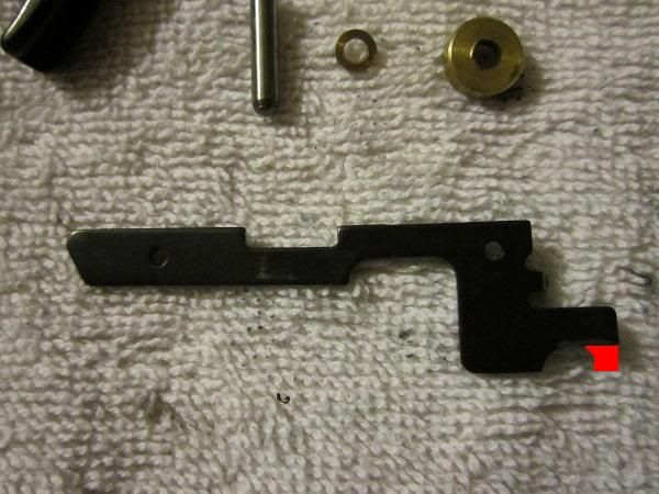

First step is to remove a redundant safety feature on this rifle and in turn remove some material that causes undue friction in the trigger pull. This feature is a firing pin cross bolt, located in the bolt itself. The "BCG" in this rifle is a two piece fixed housing/carrier that holds the bolt and return springs. Separate the halves vie phillips screws(upgraded to allens in this rifle now) and two T10 torx. Remove the bolt mechanism, and remove the two REAR torx screws at it's top. On the left side of the bolt you will see a domed `1/4" diameter pin. That's the cross bolt we are going to remove:

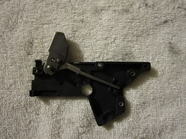

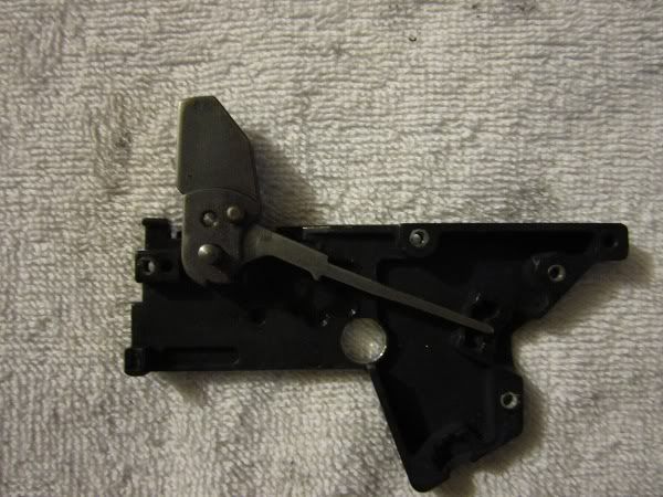

With the BCG addressed we move back to the FCG and the trigger reset plate. This large plate is what sets the trigger assembly into it's stages, and at the same time acted on the cross bolt we just removed. You can now remove a good portion of the plate that now does nothing more than add undue weight and friction to the trigger pull. The entire top portion of this plate depicted in red can be removed and the cut edge filed and polished for zero burrs:
The next step is to remove some of the GSG's ungodly long trigger pull/travel, and prevent it from being set into it's "1st stage" of pull. In the picture above you'll see a green area next to a slot. This is material that needs to be added(IE welded) in and filed to adjust the maximum travel the plate can return and thus reset the trigger. This is another step that needs to be done slowly and carefully as this can be overdone and make the trigger very touchy due to improper sear engagement. You will need to assemble the FCG and record the triggers full release state, however if you're performing this mod you should already know that and know what you're doing!
The cutout in the bottom of the plate with the back radius is the part that actuates a lever in the side of the FCG, which ultimately resets the trigger via a pin in the trigger body. As you can see....alot of moving parts where friction all adds up. The side of the FCG where this plate slides and the reset lever:
Done correctly, you can effectively reduce the travel of the trigger from full rest to full release by 50-60%. Seen here in this picture, I show(roughly) the triggers state from original full set, to the new modified set as well as the full break. Note, method of measurement here is solely to depict in visual format for you, not true way to measure.

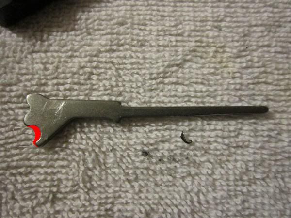

If you have modified the FCG and reset plate to limit the full forward travel of the trigger, you effectively make this piece redundant. Being redundant, it's an unneeded part that's adding friction to the pull. It's simply removed by driving out the lower pin and pulling from the trigger. The pin sits pressed fit into the safety lever and not the trigger so you won't put it back in. Normally, this part prevents the sear lift rod from dropping prematurely by blocking the lower lift rod extension until the trigger has been pulled back far enough to begin disengagement of the sear. If you wish to retain this safety feature you actually need to add material to the front of this and machine it accordingly to reach underneath the extension itself. I am removing this part from my FCG for the time being, but am going to hold onto it for future use if I decide that the rifle really needs it. In effect, this is where good sear engagement comes into play, as you don't want the lift rod dropping for no reason.
