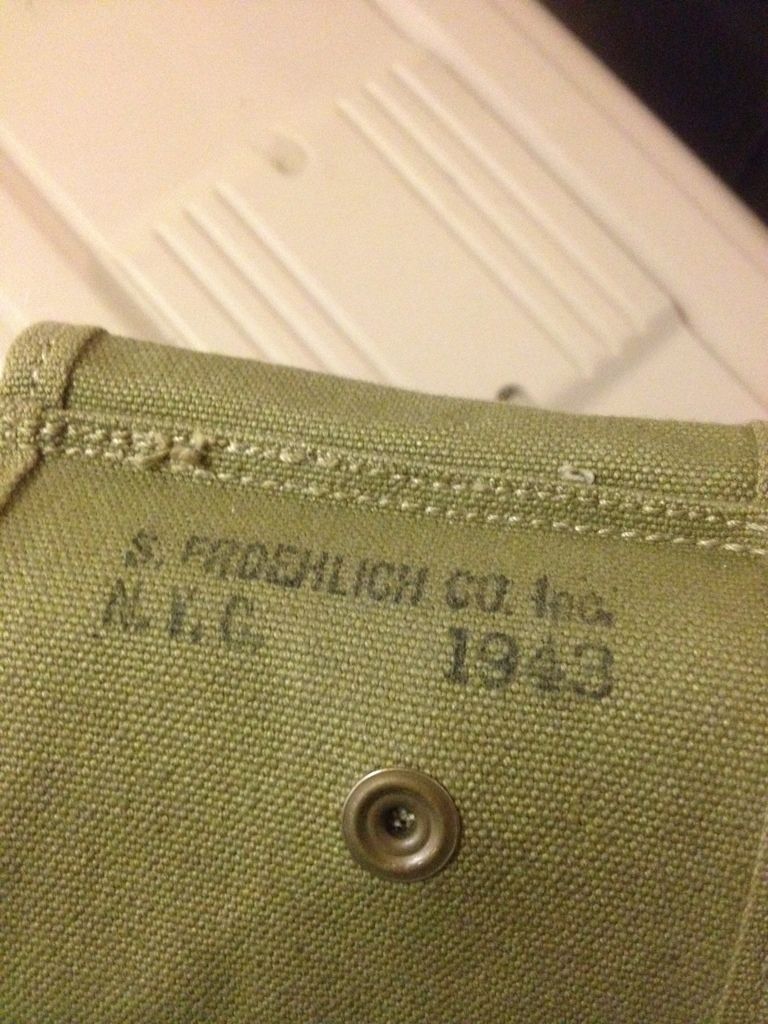

It's an Inland M1 Carbine. I don't know the exact date, but the serial number is within the first 80,000 of a documented 2,080,000+, so it's an older one for sure.
I'd really like to get a nicer or refinished stock set for it, since there's a lot of pitting on it, and I'd like to get the rear sight replaced with a correct one. Maybe a whole re-finish job is in order. We'll see.
Here's some pics:
